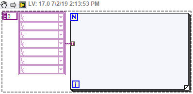

Any way that you could show an example of the for loop and auto-index on an array of GPIB references?
Message 6 of 8
(2,594 Views)
Accepted by topic author Netsballer92
Arrays, loops, and auto-indexing is basic LabVIEW.
I would recommend looking at the online LabVIEW tutorials
LabVIEW Introduction Course - Three Hours
Learn LabVIEW
Example_VI_BD
Message 7 of 8
(2,589 Views)
Thank you for the response
I thought I had to but the I/O control in the array, which wasn't working lol
Message 8 of 8
