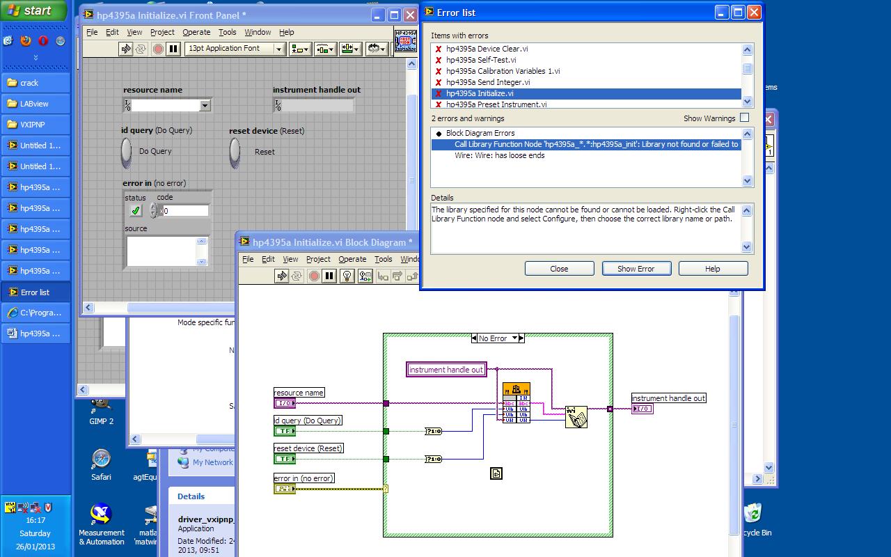

I've tried to use 8.6 version and the result looks better but still it do not generate usable VI's
all generated VI have errors like this:
How to fix the Function Library node???

OK. One more time.  Install Agilient IO Libraries.

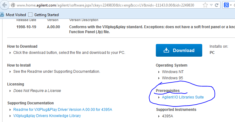

follow the link.... install Agilient IO Libraries
Message 8 of 9
(4,076 Views)
Thank you very much!!! Absence of IO Libraries vas the problem.
