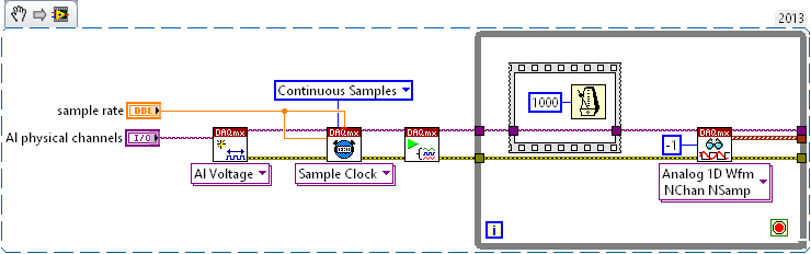

Below is a snippet to illustrate Jeff B's "wiring -1" suggestion.   Much simpler, and more likely not to have odd quirks on USB b/c it's a much more common DAQmx config for NI to support.
Further comments:
- by sequencing the msec multiple and the DAQmx Read, you don't necessarily need to do a pre-read before the loop
- reading "all available samples" by wiring -1 gives you the *option* of a lossless and non-redundant data stream.  The method I showed serves up chunks of data that may be discontinuous or may be partially overlapping.  No realistic shot at a lossless stream.
- no more property nodes to set "Offset" or "RelativeTo"
- I purposely did *not* configure to "allow overwrite."  As I mentioned earlier, I have a memory from many years ago of that setting not working well with the notion of reading "all available" samples.  After a buffer overwrite actually happens, I'm not sure what you get back when requesting "all available" samples.   Some of the ones that the driver *wanted* to consider as available have already been overwritten...
-Kevin P

Frankly, I did like Kevin's approach and would use it in the cases he elaborated on.  Thanks for teaching an old dog a new trick.
The choice between Serving up a DAQ data notifier and reading -1 inside the same loop as other things happen in comes down to how closely related the DAQ data and other things are.  i.e. a software side closed control loop or just all acquisition.  You never mentioned the other things going on but, I know you can make the right choice.
