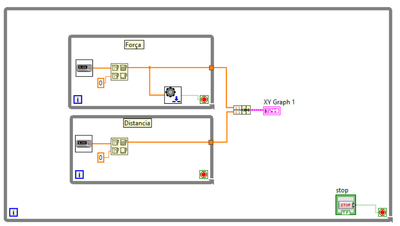

I’ll try to reorganize the code. Just to confirm—am I on the right track to get it to work in parallel?
Or did I misunderstand?

yes and no.
It runs in parallel, But following  DATA FLOW, the plot will only happen after the loops are done. If you want the curves to be plotted while they are being acquired it will not work. However if you want the plot them after acquiring the data, you are in the right track.
You may need to do some research on how to stop both loops together, and ensure that they run at a similar frequency. LabVIEW does not guarantee that each loop will run at the same rate, or one loop will run 2x as fast. You need to invest some time investigating how to do that.
Not even close. Get rid of all the inner loops. All you need is a toplevel loop and proper state machine architecture.
(Also, in your faulty code, the two acquisitions could only run in parallel if the subVI is reentrant. We cannot tell that from a picture!)

ok, I gonna post the code
but now I change I think now I am in the right path... I think
the Right one is in the "normal7"
And how do I do a "reentrant" code ?
