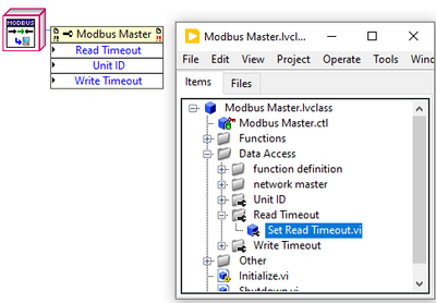

I have no experience with AF but looking at the pictures you posted I want to ask:
What happens in ActorID, which is executed before enqMediator? Is there a possibility that this VI changes the class data (e.g. due to a for loop running zero times without a shift register or a "use default if unwired" case of a case structure)?

One other idea that came to my mind.
If the 'ActorID' VI (which is called by the property node) is returning an error, I think 'enqMediator' VI will execute the 'error case'. This will return a default value ('Use default if unwired') for your object.
But I am not really sure if the error handling inside the property node is working that way.

That is how it works by default. You can right-click the property node and check "Ignore Errors inside Node" to override this behaviour. The property node then gets a red error out terminal.
You can also right-click on the specific property and select "Open Accessor VI" to get to the correct VI.
Individual properties are named after the Property Definition Folder in which they are located (the ones with the wrench).
