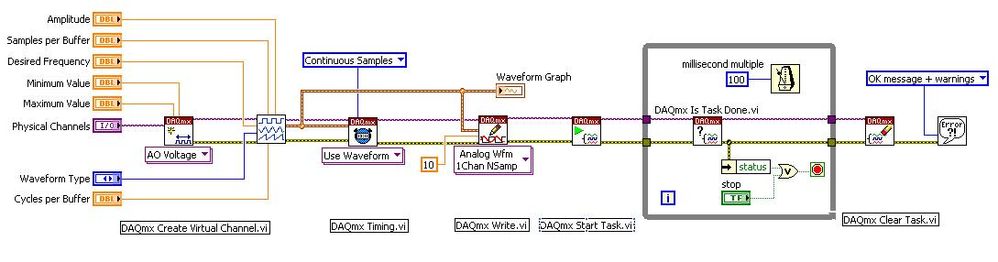

Not only you use LabVIEW 7, but you also appear to be using the Traditional DAQ drivers (T-DAQ). I’m not really familiar with T-DAQ, so I don’t know what AO CONTROL does. If you look on the Help file for NI-DAQ, it should help you with the description. However, I can help you with what goes on with the DAQmx drivers.
Now, what happens in DAQmx on a regular continuous generation is: When you call the DAQmx Write,  you are writing the waveform you built in software to the ADE memory (LabVIEW buffer). When you call DAQmx Start, you transfer the data from the ADE memory to the PC buffer. Then, the PC buffer will transfer the waveform to the DAQ card’s FIFO.
After that, a couple of things can happen: If you have regeneration activated, the FIFO keeps the samples it was transferred and just re-runs them. If regeneration is not activated, then the PC buffer is continuously sending information to the DAQ card’s FIFO.

As a note: I highly recommend you migrate to DAQmx because there are very few people (if any) that know T-DAQ as well as DAQmx.
