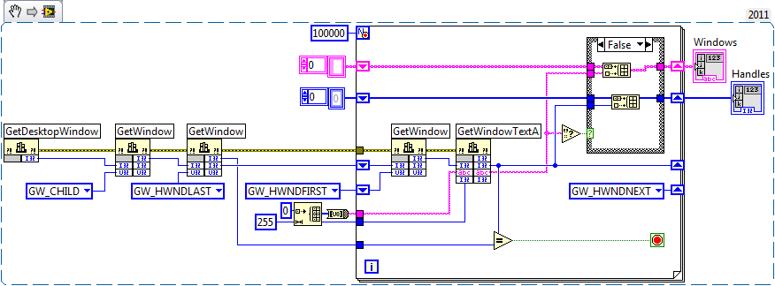

My workaround for my problem was to call GetDeskTopWindow (which contains all top level windows as child windows), call GetWindow with the GW_CHILD constant to get the first top level window handle, then iterate with GetWindows using the GW_NEXTWIND constant, retrieving the window handles until I get a window handle that's not a window handle (test it with IsWindow).

Perfect layout John:
I did exactly as you had layed out and attached is a copy of a working vi I made in 8.2. If anyone else wanted to get all running windows and their handles take a look at my vi.
(7,067 Views)
I was using similar routine to EnumWindows and use first and last hwnds to complete search and only enum windows with names.
