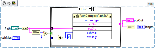

Those of us stuck in older LV can resort to a helpful Windows API function.
