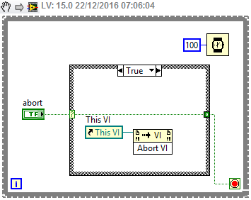

I really hate to give "bad practice" advice, but anyway, you wanted...You can use the "Abort VI" invoke node: http://digital.ni.com/public.nsf/allkb/4B2CAA3159737AFD86256F2B00788A79
But this neither will help you, if your design is so bad that for example you put long executing code in your Event structure case(s). If your GUI is locked up, you cannot fire this "Abort VI" from your Event loop.
Or you could create a parallel While loop with an Abort button connected to a Case structure with this invoke node inside (plus like a 100 msec Wait in the while loop, not to burn your CPU)...
