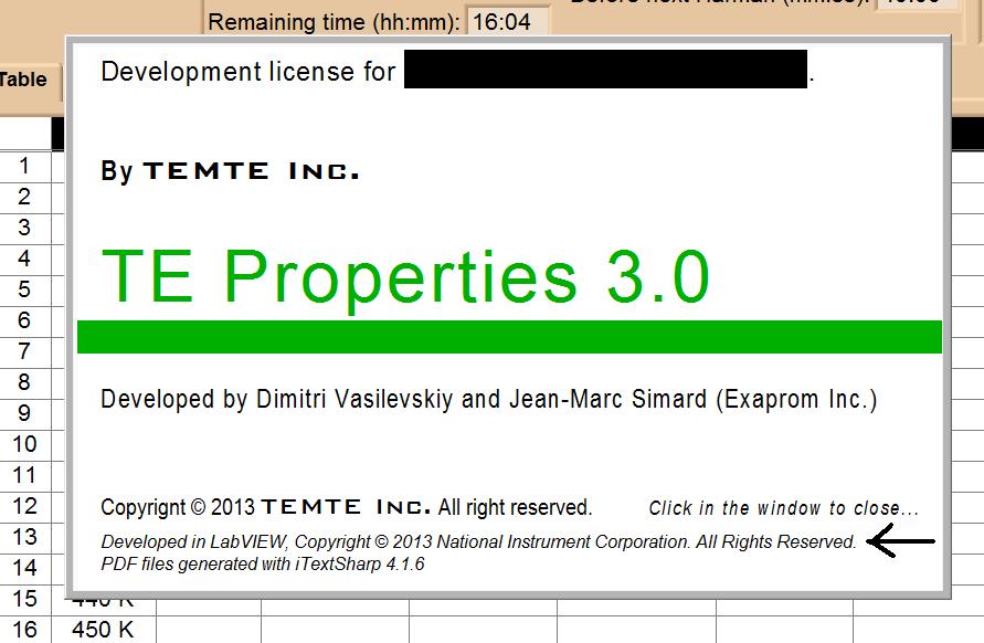

About Dialog Box end copyright notice: question for NI
This copyright notice is in accordance with the National Instruments Software License Agreement or do I specify the run-time engine [year] and the drivers (NI-488 x.x.x, NI-Serial x.x and NI-VISA x.x)?

Just another question.
This software is in LabVIEW 2009.  I presume, I will have to write:
"Developed in LabVIEW, Copyright © 2009 National Instrument Corporation.  All Rights Reserved."
instead of
"Developed in LabVIEW, Copyright © 2013 National Instrument Corporation.  All Rights Reserved."?

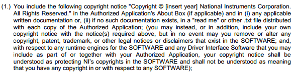

The software license agreement is found here:
http://www.ni.com/pdf/legal/us/software_license_agreement.pdf
If you Ctrl+f search for "application deployment" this should point you to the correct location (see below for excerpt).
