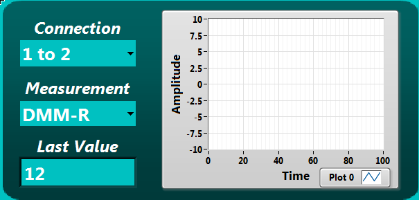

My thoughts were to have 4 separate controls that can be set to access specific aspects of the test while it's running to make this work. My idea is to have (4-6) something similar to the below:
This way the user can narrow down exactly what they are looking at as it happens.

It's not that easy unfortunately. There is a possibility that I have 20+ "connections" with measurements being taken across those connections. How would the user be able to narrow down the data to something worth looking at.
The matrix might take measurements across pins:
1 to 2
3 to 5
6 to 3
7 to 20
4 to 5
And then repeat that sequence every minute. How could the user then narrow down the data to one of those connections, and one type of measurement if the data were saved into a chart?

;How much data are you talking about?  Is it low enough that you'd be able to keep the entire array in memory?  If so, then I would use your option 2.  Then design an interface that allows the user to determine what connections they want to look at, and your program would parse through that array gathering together the applicable data and display it.
If it is too much data, then you will have to go with the TDMS or some other file storage option and have to read the data back in piecemeal and build your array of the data that applies to display.
