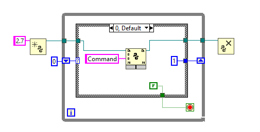

I attach here my code in a simplified version.
I am not sure it is easy to run it as it requires installing special libraries like rdkit.
 I spotted the error when I noticed that the output from the python node doesn't make lots of sense, so I thought that there is something wrong in the python script.
Normally I run the code in a loop by feeding the python script with new input data. So I took a constant input and I run it in a loop and I expected that the python node will give the same value as nothing is changing.
Indeed, when the Python node is inside, the output is constant but the moment that I put the Open node outside the while loop, I get crazy numbers which seems that Python is not controlling properly the data communication.
Message 13 of 18

Hi ziedhosni,
I face the almost similar issue as yours.
I have placed the open session and close session outside the state machine.
Every state of the state machine will send a command to DUT with specified port and get some response.
However, i found that the session input to the python node is sometimes unreliable and gives me weird output.
I saw you mentioned about specify the random seed in python code to avoid generating new staff in each iteration. I am not so familiar with Python. Can you please advise? Thank you.
