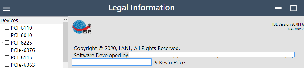

Thanks Kevin for the kind words.
FYI you are on my About Menu because of your forum advice. Need to figure out a way for you to critique our work.
