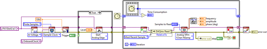

hello Kevin
Thanks for your suggestions
I have not used a retriggerable analog start trigger. So I have not modified the program after your suggestion.
My DUT signal is exactly a modulated signal with parameters of 10kHz, >0.1Vp-p, and >1% modulation index.
On the first try, I started with a sine wave signal which I used to get after demodulation.
Here I have attached the program which I have used for acquiring and extract the signal tone.
The above program was used as a final before posting this query. Let me know for suggestions.
Note: The program is developed for Trial & Error. Kept Start & Stop function inside the loop is a try to get data every time since tried using finite samples mode.
Boopathy Raja S

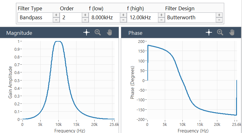

Sorry for the confusion but still not sure of your final application.
Looking at your VI, it seems you want to measure/record Amplitude, Phase, and Frequency. This indicates that your frequency is not static, it seems like you want a frequency-response curve similar to one shown for a filter plot, like below.
Is that the type of curve you want?
If your signal is stationary, that is, the frequency is not changing, do you just want to monitor the change in amplitude phase over time? If so not sure why you are measuring the frequency of your signal.
If you are doing a frequency sweep, the method I suggested would work, but, it would be impossible without a frequency reference unless you can control the sweep rate from LabVIEW.
The other issue is your signal. You state, My DUT signal is exactly a modulated signal with parameters of 10kHz, >0.1Vp-p, and >1% modulation index.
Modulation index implies to me AC/DC, so do you have a small sinusoidal riding on top of a large DC offset? You say exactly 10kHz, so I assume it is stationary.
The method I suggested determines the instantaneous magnitude and phase of your signal. You can think of it as a narrowband FFT centered around the frequency of interest. A FFT means you are multiply by all the frequencies in your signal, here we are multiplying only by ONE frequency. The width of the band is determined by your LP filter, a 1kHz LP filter implies a 1 kHz bandwidth with a response time of 3-5ms. (Five time constants are better but three could suffice.) The advantage of the method I proposed is that you can synthesize your own reference and measure relative to that reference. Since you control the reference it should be steady.
This link, https://forums.ni.com/t5/Example-Code/Lock-in-amplifier-with-DAQmx/ta-p/3698819 ,
uses an external reference I believe, but you can make your own internal one. I did the same thing for a FPGA where I made my own 40kHz signal and multiplied my input by it.
mcduff

Let me tell you what I *see* in the code you posted, then you can figure out if what's there is actually what you *want*.
1.  You have a finite sampling AI task, sample rate of 10 MHz, buffer size of 10 Mega-samples which will be 1 second worth of data.  Note that in the case of a finite sampling task, you should wire up the # samples input of DAQmx Timing to define the total # samples you want to capture.  Once you do, you'll no longer need to call DAQmx Buffer explicitly.  (Things work differently for continuous sampling tasks.  I consider this to be unnecessarily confusing and posted a complaint and partial suggestion on the Idea Exchange.  Please feel free to add to the discussion or add a Kudo to the idea.)
2.  You're configured for a one-time analog edge start trigger.  You could make the task retriggerable (assuming your device supports it) by following up your general trigger config with the corresponding DAQmx Trigger property node.
3. Each loop iteration, you start the task and request an unknown-to-me # of 'Samples to Read' from DAQmx Read.  You didn't wire the timeout value, so the 10 sec default is probably being used.
   When the trigger conditions are met, the task will start moving data into your task buffer.  Once you've accumulated 'Samples to Read', the function call will return with your data.  But if the trigger conditions are *not* met, the function call will get stuck waiting until the 10 second timeout expires.  It will then return with no data and a timeout error.
4. After the read, you stop the task, which sets you up to be able to iterate again.
5. Your first post mentioned something about "consuming more time than usual."  There are 2 places for time to be consumed once you call DAQmx Read.
- acquisition won't start until the triggering condition is met
- after that you'll wait until 'Samples to Read' have been transferred to your task buffer.  The longest additional time this can be is 1 second if you're asking for the entire buffer full of 10 Mega-samples.
6. Note that the DAQmx Read property node set to 'Most Recent Sample' is not helping you here and may possibly be hurting.  Remove it.
7. To try retriggering, you would need to move the task start and stop outside your loop.  You may run into issues with hardware-based retriggering though.  The task wants to rearm the trigger as soon as it captures the total # samples defined in DAQmx Timing.  But unless your software has already read those samples from the buffer, there will be no place to put new samples after the next triggering event.
    Since you trigger on a regular characteristic of your waveform, that's gonna happen really fast and I kinda suspect you might start getting buffer overflow errors.  These basically kill your task,  which would require you to stop and restart it.  At which point, there may be no great advantage to hardware-based retriggering over the software-based repetitive triggering you posted.
-Kevin P

Hello mcduff
Sorry, I am into any kind of response curve. You are into different tracks which I am not looking exactly.
I am not using any frequency Sweep.
I have not noticed any DC offset as you mentioned from my DUT.
The guess the link which you have shared might be useful. Let you once thought-out completely.
