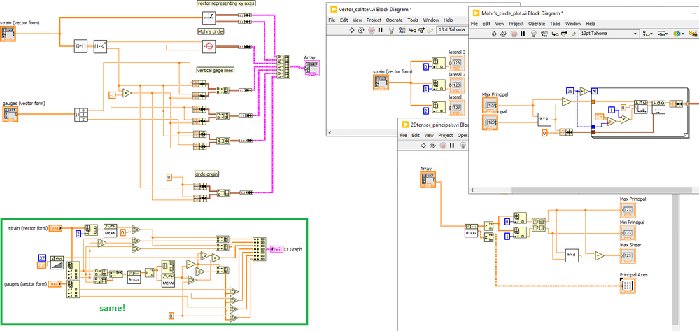

I noticed that you seem to use xy graphs as a gauge display. I would recommend to use complex data, significantly simplifying the code.
Here is a comparison with all code flattened to the diagram (green). You can easily wrap some sections into subVIs again.
