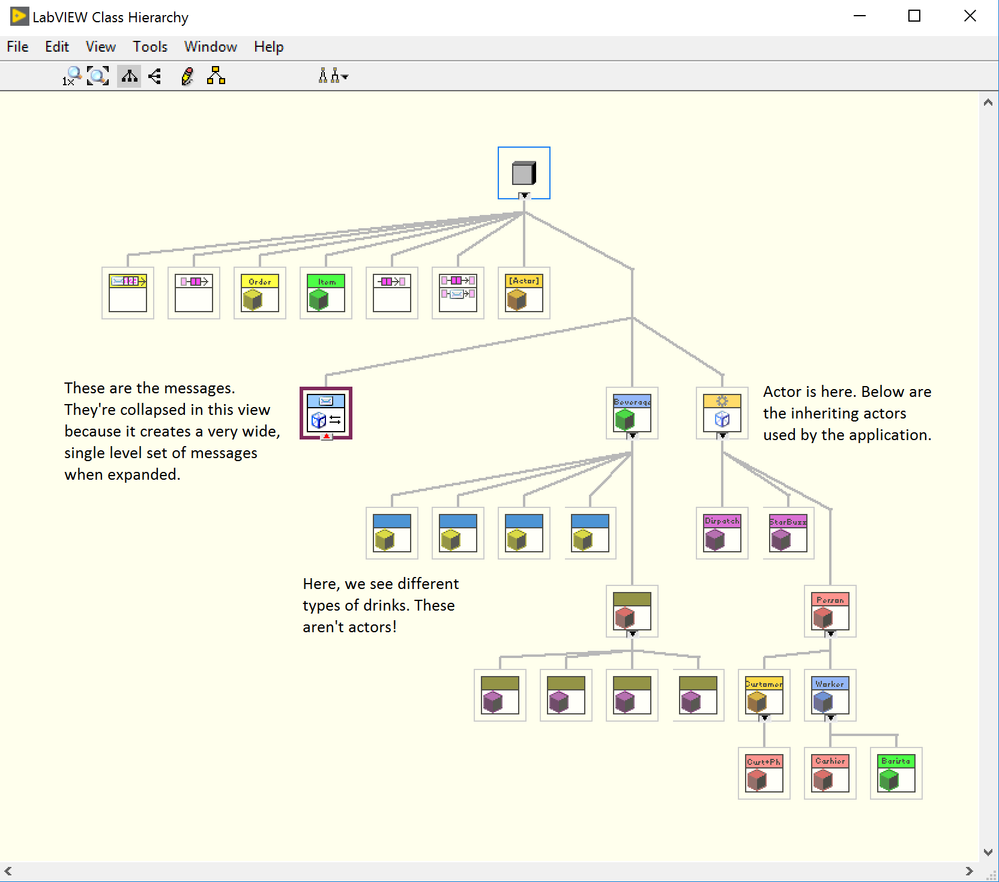

If you're looking for a more useful (in my opinion) example than the template, then Matt Pollock's Coffee Shop example described in this thread is really pretty good (although a bit more complicated, you get to see it do something). I'm not certain if there are minor bugs in the code when you try to do strange things, but it's certainly illustrative of a way to group sets of actors together to do something nice. It also demonstrates the benefit of actors being independent - you can have a bunch of separate customers each as a new instantiation of the same actor-inheriting class. I've placed an image of the class hierarchy below with some comments to incentivise taking a look!
