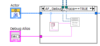

Debug mode handled inside of Actor.vi in this way, so may be you can use Debug Alias to identify which one was locked:

Thanks. I started using justACS toolkit for debugging.
