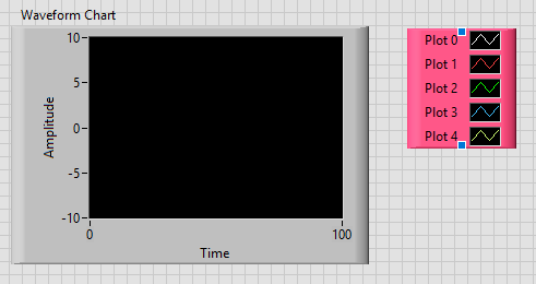

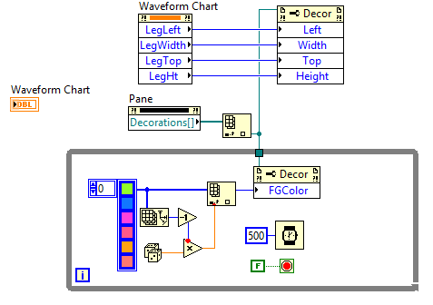

Setting the Graphs frame color is a problem for me. It won't actually update the frame color until I stop the VI. In LV13, so maybe that got fixed. EDIT: the same solution will do the trick.
Message 9 of 14
(3,920 Views)
Interesting.  So the VI you posted is telling me that the frame of the plot legend is actually a decoration exists on the front panel and is not a part of the graph control itself?
That begs the question, how do you change the color on a specific one?  I duplicated the chart and ran the VI.  With you VI, there was exactly one decoration in the array.  So I figured putting the 2nd chart would give me two.  Nope, still only one decoration in the array, and its color does not change.
