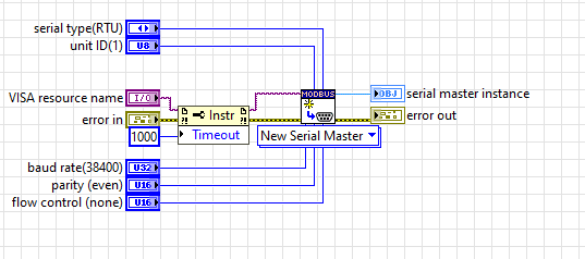

Hi this is more of a feasibility discussion, so if you have an answer to any of the questions I am about to ask then please write in. I am trying to control multiple devices using a Modbus serial master controller VI. I know that I need to identify each device by their individual serial ID number, but I am wondering what is the best way to control that process to allow me to switch between which sensor I am reading. Basically, I want the master program to be reading the holding/input registers from multiple devices while I choose which sensor's values show up on the graphs. With that in mind, I have a few questions about which approach makes the most sense and is more reasonable to attempt to implement.
1) Should I use an array to store the ID numbers?
2) Should I use the attached VI as a sub VI in another project and call it for each COM port connection I have?
3) If #2) is true, how would I determine which sensor's values to show.
I know there are other questions I have not asked, so please write in if you have any suggestions. Thanks for your time.

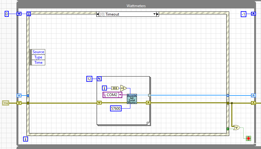

I did a project that has 12 power analyzers.
Since all 12 instruments were identical I used a very simple approach.
First I made a set of VI's that use the Modbus library for my specific tasks
I set meters up to use sequential Unit ID's, so I could initialize all my meters using a For Loop
Inside my Init Serial Master

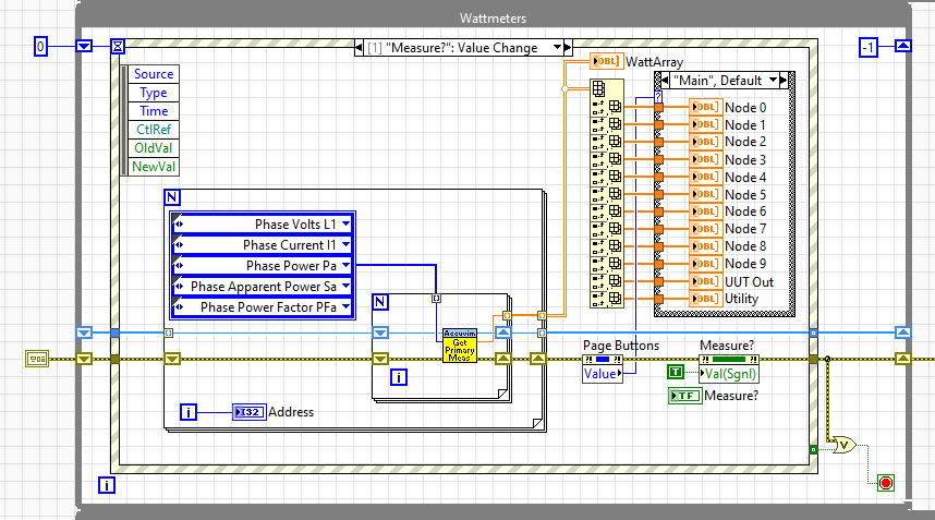

This is how I take measurements, again since all the meters are taking the same measurements I used a For Loop. The "Address" indicator is normally hidden and can be toggled for troubleshooting with a key press.

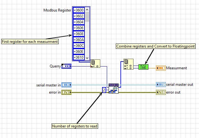

Inside my Get Primary Measurement VI
Your program architecture is a little messy but at least it's a state machine... So it should not be too much work to modify it to something like I did. You might what to think about making sub-VIs for all your Modbus interactions too.

  1. I don't understand what you are asking... You need to open a "serial session" for each device and you can open all of your serial sessions at once with a For Loop.
  2. Well that's up to you. In my case I have a tabbed interface so the end user can tab through each device and see that devices readings in graphs and tables. Plus a "main" tab that shows the measurements we are most interested in for all devices on one screen.
  3. It depends on your measurements and how often you need them updated. In my case I am retrieving the same register values for all 12 devices so I made a Sub-VI to get the registers I need and put it in a For Loop
