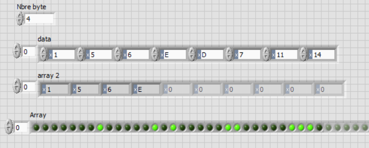

As you can see in the picture, it is not woking. It is wierd. It is not working.
Message 38 of 47
(2,335 Views)
Hi fatemeh,
it is working with my LabVIEW version. That's how the FP looks after running the VI with "Nbre byte"=4:
Message 39 of 47
(2,327 Views)
