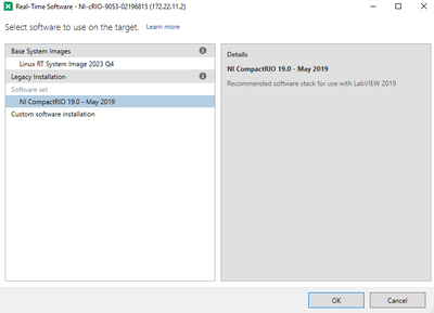

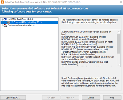

I have the following error when I install Software on Real time Software NI-Crio 9053 on MAX.
"the recommended software set cannot be installed because the following components are missing on your local systems":
Avahi Client 19.0.0.2014 (newer version available on host) NI Chenum Driver 19.0.0 (not available on host) NI-MDBG 19.0.0 (not available on host) NI-PAL Errors 19.0.0 (newer version available on host) NI-ORB 19.0.0 (not available on host) NI System API 19.0.0 (newer version available on host) NI-APAL 19.0.0 (newer version available on host) Target Configuration 6.0 (not available on host) NI-PAL 19.0.0 (not available on host) NI System Configuration Remote Support 19.0.0 (newer version available on host) NI-DAQmx Combo System API Expert 19.0.0 (not available on host) Software Installation WebService 19.0.0 (newer version available on host) NI FSL Components 19.0.0 (not available on host) NI-DAQmx Remote Service 19.0.0 (not available on host) NI-KAL 19.0.0 (not available on host) NI-BDS 19.0.0 (not available on host)

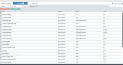

In attachment there is the snap of my packets installed on the PC.
I cannot understand what packets are missing.

It seems like you don't have LabVIEW Real-Time Module installed.
