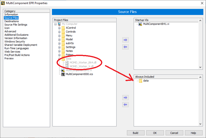

By default, only things are included that are obvious dependencies of the startup VI(s). It is possible that the exe builder cannot determine that these dlls are required at run time (e.g. if they are called by filename (specify path on diagram) or if they are secondary dlls (i.e. called from within other dlls) or similar).
Easiest is to list them in the "always include" field.
Here's how it currently looks for one of my programs where the dlls are exclusively called by filename.:

Thank you very much.
This solved the problem and I learned from that for next time.
