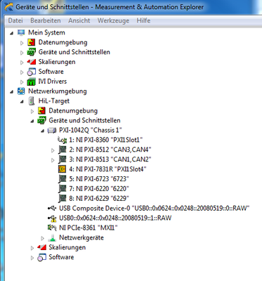

I have been using Veristand for the last couple of months with the following configuration:
All listed devices on my remote Computer (HiL-Target) work fine.

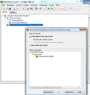

My Problem is the following:
When I add my remote Computer to my Labview Project, Labview only finds the FPGA:Labview_add_device.PNG
Any Idea why the PXI-851x don't appear in this list?

Step1: I see all my devices in MAX -> OK

Step3: Labview finds the FPGA on the target Computer (so I'm sure the IP-Address is alright) but no PXI-851x -> NOT OK

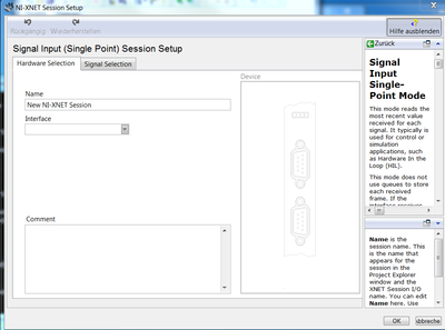

The article says "To get started, open a new LabVIEW project, right-click My Computer, and select New»NI-XNET Session. In the resulting dialog, the window on the left provides an introduction to the NI-XNET session in the LabVIEW project. The introduction links to help topics that describe how to create a session in the project, including a description of the session modes"
When I do as instructed, no Interface is found:
And when I try to right-click on my Target Computer (which is connected to the PXI-851x) in the Labview Project window, the Option New»NI-XNET Session isn't available.

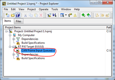

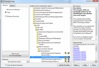

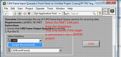

I created a small step-by-step tutorial:
1. Go to the example finder and select a suitble example. If you are new to this probably start at the Frame Sessions or Signal Sessions:
2. Copy the selected example VI to your project
3. Add the example below your PXI real-time system:
4. Open the example and select your CAN port from the drop down. Your PXI system has to be connected (right-click the PXI target in the LabVIEW project and select "Connect" (the LED should turn from dark to bright green in the project)

Hello and thank you for your answer.
I am still stuck with my Problem.
I found the example you mentionned and was able to open it.
I still can't add a PXI RT System like you did in step 3.
In my case the PXI is behind a remote Computer (see the first screenshot of my first post).
But when I add the example VI below my remote target, it can't find any CAN channel in the drop-down list.
I would try to add an "RT PXI Target" like you did but this Option is not offered to me.
So maybe something is wrong with my XNET Driver? (Everything is fine under MAX and Veristand though)

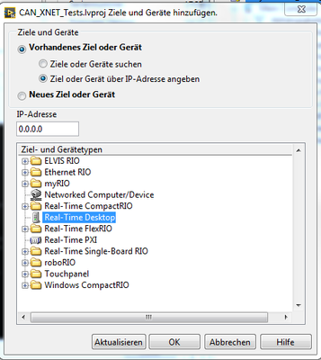

Accepted by topic author Tranbi
after having struggled for while I found the solution to my Problem.
First I had to install Labview Real-Time Module on my host Computer.
Then I was able to add a "Real-Time Desktop" to my Labview Project:
After That I had to right click on the added RT-Desktop and select "Connect".
Only then was I able to find my CAN Interfaces under "New>>NI-XNET Session".
Hope it might help other People with the same Problem!
