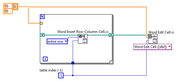

There is a VI in the RGT called "Word Insert Row-Column-Cell".  Just call this function in a for loop as many times as needed and then add your data into the table using the "Word Edit Cell" function set to array data type.  Be sure to set the table index property for both functions.

Yes aputman's solution above works very well. Sorry about the late reply and thanks to those above for the help
