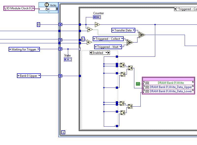

I am writing a data acquisition code for the 7962R with the 5752 Adapter Module using LabVIEW 2012. The basic idea is similar to the "Finite Acquisition Multiple Channels" example with additional features for larger data sets. The FPGA waits for a trigger on the PXI backpane; acquires a 16 channels at a user defined rate (~10 MHz) for a user defined number of points (> 10K); and saves them to the DRAM. Once this is completed, the DRAM then transfers the data to the host computer using a DMA FIFO. For small sets of data I can get this to work storing data in target scoped FIFOs. However, now that I have added DRAM, the code seems to work the first time the acquire button is pressed, then on subsequent acquires, returns the correct number of points all with a single value.
I am currently using the DRAM as a FIFO, as this seemed the simplest implimentation. I understand there are alternatives, but am unsure if I made the correct choice.
Also, if I understand correctly, the analog channels must be acquired using the IO clock on the 5752 card. Can I use this same clock for writing and reading data to and from the DRAM?
Any suggestions as to why each channel has a fixed value after the first acquire would be greatly appreciated.

tannerite, I made the modified the code to disable the actual inputs and just use the counter into the DRAM as you suggested in your figure above. I now always receive a single value as the output, which is the same for every channel. I added a latching time out indicator for the DMA FIFO. This never latches. I added an indicator showing the last data point read into the DRAM and the last data point read from the DRAM into the DMA FIFO. These were not the same. I added a latching 'Full' indicator for both Bank 0 and 1 DRAM banks. Both of these do latch. I am confused by this for a couple of reasons. First, the DRAM FIFO should be cleared when the card is reset at the beginning of the code running on the host machine. The code uses a counter to ensure that only 5000 points (or whatever the user specifies) gets written to the DRAM. The PXIe-7962R has 512 MB of onboard RAM. I don't see how I could fill this with 20,000 64 bit integers (5000 x 4). Second, looking at the help file for the FIFO - 128 Bit Memory Interface, the second to last paragraph states, "The FIFO - 129 Bit Memory Interface is designed to simultaneously read and write data at speeds up to 40 MHz. It is possible to run the interface up to 200 MHz. However, at speeds greater than 40 Mhz, the 'Full' and 'Data_Available' signals may temporarily become TRUE and FALSE, respectively." Since I am using the IO Module Clock (50 MHz), it seems like the 'Full' indicator may be unreliable. I repeated this with the DRAM clock and loop clock set as the 40 MHz clock and the same thing occurred. So somehow, the DRAM is filling up. I'm at a bit of a loss for how this is happening though.

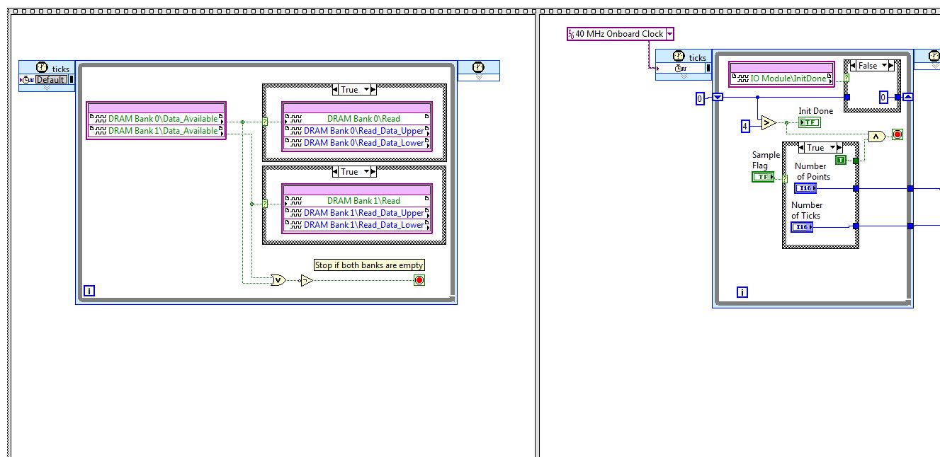

It will also be helpful to clear your DRAM at the beginning of your FPGA code. I attached a screenshot of how I would accomplish this.It is possible that you filled up your DRAM in the past so reading all of the DRAM at the beginning should effectively clear it.

I have added code to clear the DRAM FIFO. I had to add it to the state "Waiting for Trigger" because I use the IO Module Clock for the DRAM. When I tried to exit the loop as indicated in your screenshot, I would get an error message stating that I cannot exit a loop that uses an external clock. I think my solution should do the same thing that yours does though. I also added an indicator to show when the DRAM banks were empty so I would know the system was ready to trigger. I did not want this one to latch.
When I ran the code, the indicator would rarely be lit, meaning it would occasionally light up, but only for short periods of time (<1 s). I believe this means that either there is a problem with the Data_Available or something else is writing to the DRAM FIFO. I have attached an updated version of the code below.

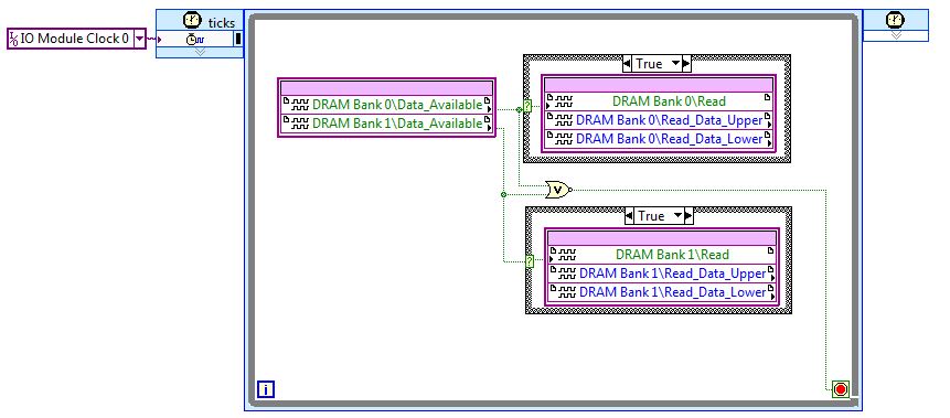

It like this may not behaving in the same way as I was wanting. Having a loop at the beginning of the code while make sure it reads all of the data from DRAM at the beginning. This should allow you to have access to all of the DRAM in your actual state machine loop. Could you reference the IO Module Clock as shown in the below screenshot? This loop is iterating through all of the elements in DRAM and reading them which should eliminate them from DRAM at that point. It should only need to be implemented at the beginning as it looks like you are successfully reading and writing from DRAM in your main loop. This is a good check to verify that the reads and the writes are working properly, however. This is essentially creating a clean slate before your actual program starts. If you create a new frame at the beginning of your sequence and add the following code inside of that frame, that should effectively clear the DRAM before your main loop executes.

On Friday, I had tried what you are showing in the picture with having the loop at the beginning. During the compile process, I get a Code Generation Error. "Loops using external clocks must never exit." The details say
"FPGA VIs do not support exiting loops that use external clocks. This restriction keeps improper block diagram execution contained within the loop if the clock glitches or setup/hold requirements are otherwise violated on flip-flops in the single-cycle Timed Loop. Unwire the conditional terminal for exiting the loop."
This is why I had moved it to the first state in the state machine.
