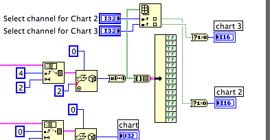

I have a device that sends out multiple channels of data via TCP.  I created a VI (attached) which parses this data into multiple integers.  I can connect a chart (I am using strip chart mode) to any of these inputs.  The problem is there are about 50 channels and I do not want 50 strip charts.  I would like 4-8 charts, with the ability to select the input channel for each using a control.  Any ideas on how to accomplish this?  Thanks!

Use Index Array.  Connect the boolean array to Index Array. Connect the channel selector to the Index input. Wire the output to the chart through the Boolean to (0,1) primitive.
For multiple charts expand the Index array and connect the selector for each chart to a different Index input.
Lynn

Thanks a lot - you got me going in the right direction.  Now I have the first major part completed - I have multiple charts, each of which can select any channel for display.
