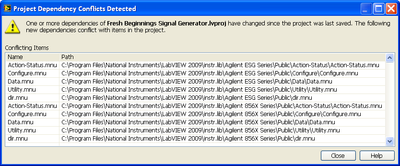

Ok the pic is what you have seen before. I snagged a better capture program for this rig. Feels like I'm back on a 386sx. sigh...
-That was a very effective screen shot by the way. 🙂
-So is there a way to find out why Labview thinks these dependencies will cause conflicts with "items" in the project?

Yes, Last time you saved them the mnu files got saved to point to the wrong location.  (Had you not moved the driver out of instr.lib\ it wouldn't have happened.
Either save the driver again or just delete the driver and re-install it in the right location and leave it there.

I shall follow your earlier instructions to correct the drivers. Thanks again 🙂
