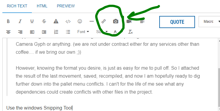

Quick tip.  Jpg files are just awful use the snipping tool to save png files and see that 📷 icon ? Click it then drag n drop the png inline with the text.
Those mnu files are for pallets  and, you still have the instrument driver in the project and at the wrong file location.  Place the driver in <LabVIEW>\instr.lib\ and remove it from the project.  It will show up in dependencies like vi.lib.
Do a save as (png is the default)
Click THAT camera in green Drag-n-drop Capture.png Capture.pngclick done
