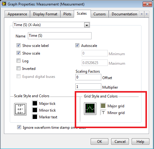

Hello word 505,
If I understand your question correctly, you need to add reference lines to the graph itself, rather than plotting data- is that what you're looking for?
If that is the case, you can change the appearance of the background grid by right-clicking on the graph and going to Properties>>Scales>>Grid Style and Colors.  You can adjust the color and spacing of the X- and Y-axis major and minor grids here, the example you provided has them set to transparent/invisible.
