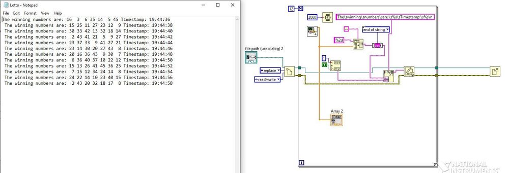

In the following VI i have created a random generator for all unique numbers to be exported to a Notepad file, upon opening the file i noticed all the numbers are stuck to each other. I have tried to convert to string and add a space before placing it into the Array but then the loop to check if its unique doesn't seem to work anymore. Is there an option to export numbers like this with spaces between them?
Lotto Random is the random generator as a SubVI.
Ps: i have also tried to export it to a CSV using tab constants to space the 3 parts of text ('The winner is', numbers, timestamp) in different columns but it still writes it all out as 1 column, doesnt tab work like that in Labview?
Thanks in advance and kind regards!

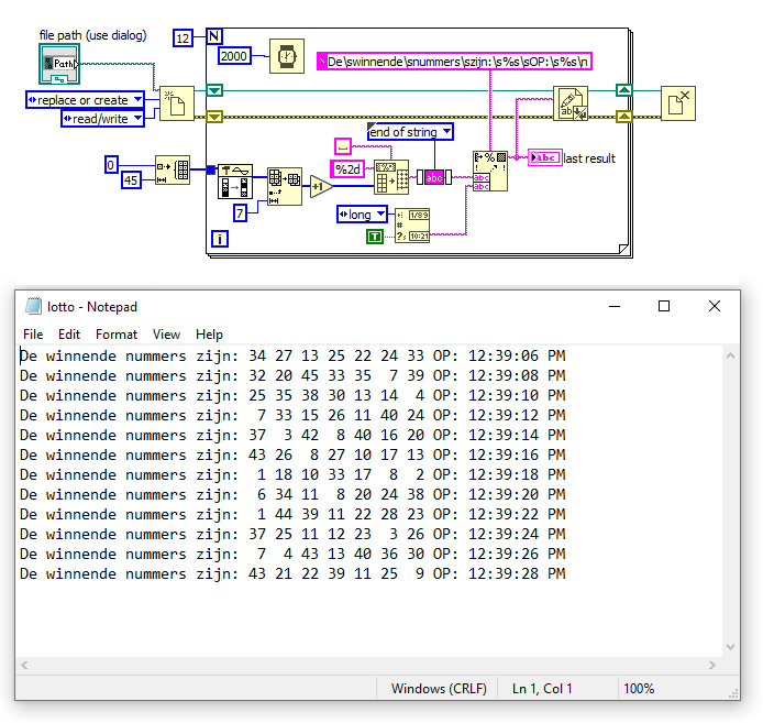

The subVI should not operate on strings and should still return a numeric array as before. To convert the array to a string with defined delimiters, use "array to spreadsheet string".

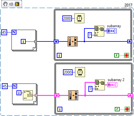

And here's an alternative way to generate the lotto numbers.

Here's a simple alternative (no code, see if you can create it). Note that you could also use "format into file" directly, combining the last two operations inside the loop. If you want, you can sort the entries.
Be aware that using a variable number of spaces between numbers makes it slightly more difficult to read it later with a program.

Just FYI, in >LV17SP1 you can use the Shuffle 1D Array.vim.
Using this VI, you can choose to shuffle either numbers or strings.

Thank you very much for your help everyone! I was able to understand the different steps used in the shown program with the exception of 1 being the format string constant at the top. What does the %s do? Also i have noticed that there is a \ in front of the string constant, what does this do? When outputting my numbers now it does it all correctly but after a break to the new line (because of the \n if i understand it correctly?) it starts with a break like shown in the picture. Is this related to that \ at the front of the constant?
I have looked at the type of the array and indeed it should come out as an array of integer values but it shows as an array of doubles, any way to change this without having to make a new array? Thanks again!
