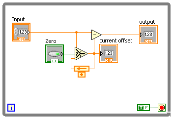

Here is a very simple way to adjust an offset
It needs to be placed in a Loop, but I asume that exists anyway.
