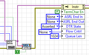

I am troubleshooting communication between a product and LabVIEW using the serial port.
I have a tool created by the engineering team for debug that was written in C, that works.
I have found a work around, I install the Keysight IO Library as a secondary VISA, and then I can use LabVIEW just fine to communicate to the device.  But I shouldnt have to do this, since this is a simple configuration.
Serial Port ConfigSerial Port Config
Another observation using the Device Monitoring Studio when looking at the Serial Port Lines.
Engineering Tool:  RTS and DTR are green, CTS, DSR, DCD and RI are red
LabVIEW: RTS and DTR are green, CTS, DSR, DCD and RI are grey
Question: How can I correctly set the values to match the debug tool, since I have been unable to locate the properties via LabVIEW ?  Queue Length, Flow Control, timeouts, wait mask and clear DTR.  It also seems the CTS, DSR, DCD and RI are set to unasserted, but the help file seems to indicate that NI only allows that via NI Serial hardware, and I am using a stock serial port on the PC.

I am not sure where you are looking.
In my LabVIEW 2015 I see under VISA Advanced ---> VISA Property Node  a whole bunch of settings that are possible for Serial Settings .

The symptom was that the device was not waking up to communicate.
I have to send out 1000 bytes at the start of the communication to "wake up" the device,  I forgot to mention that for the buffer size.
I was able to get this going, by toggling the DTR line.   Assert the RTS and DTR, wait 100 ms, unassert the DTR line, wait 100 ms, and then assert the DTR line again.
