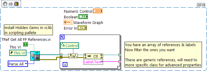

Install the package Hidden Gems.
You can then traverse all objects, get their labels and filter the controls depending on their label.
You may need to use to more specific class for advanced property nodes. (version 2015 attached)
mcduff
