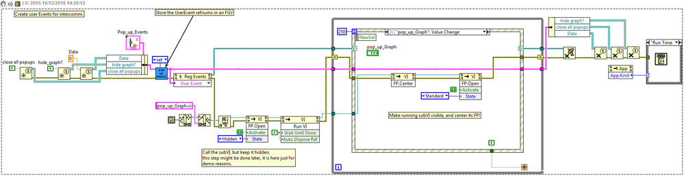

I also often use pop-up windows. I call a subVI dynamically, and I give the user options like hide/close/reopen these pop-up windows.I manage intercommunicaton between these pop-ups and the main VI via UserEvents (to send messages, data, error handling, etc.).

Hi Blokk, you suggestion sound clever, but is the intercommunication complicated? How do you do it using UserEvents? Could you point to some sample codes please?

Well, lets say it is not a basic level of LabVIEW, you need to program a bit to handle dynamically called pop-up windows. There are different ways to call subVIs dynamically, some aspects are discussed in these white papers:
https://knowledge.ni.com/KnowledgeArticleDetails?id=kA00Z0000019MqkSAE&l=en-US
https://www.ni.com/docs/en-US/bundle/labview/page/asynchronously-calling-vis.html
https://www.ni.com/docs/en-US/bundle/labview/page/asynchronously-calling-a-vi-and-collecting-the-res...
What is important to setup a communication method between these parallel VIs. So for example, when you quit your main VI application, the parallel subVI needs to get a msg about it, and close itself, etc... You can use either Invoke Nodes, or Async Call Nodes. I often use clones of reentrant VIs for pop-ups so only using a single subVI, it can serve several pop-up windows at the same time parallel (dynamically changing indicator captions, and so on)...
I attached an example project very simplified, but it might give you some idea how UserEvents work. In this project I just keep the parallel pop-up VI running hidden, of course you can do it differently, like always stop it and restart it, etc...
Communication: practically VIs can subscribe for an Event, and you can trigger an Event from anywhere. A functional global variable (FGV) stores the User Event refnums.
