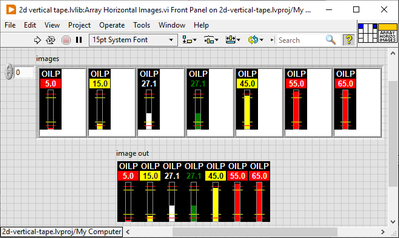

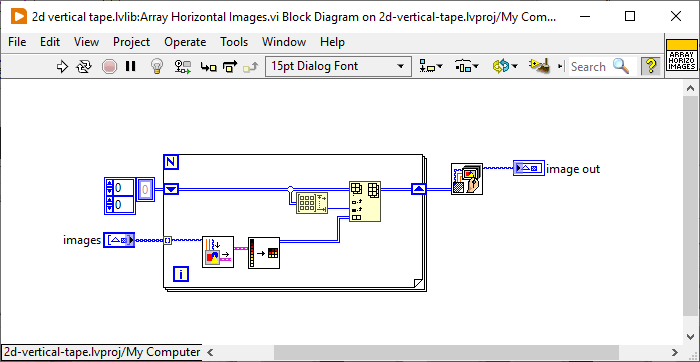

We do expect to have groupings of indicators which would fit into at least a 1D grid. I don't know what the overhead is yet, but I did make a VI below to assemble an array of images into a single image for display on the front panel. That replaces the need for a zero pixel image border, but it may not be as good from a memory reallocation perspective.

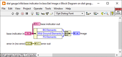

I've tried to reduce processor load when assembling the images. I have 3 images in my class private data, background, midground, and foreground. I also have two drawing methods, Draw Static Elements, which is called once to draw all elements which do not change when operating, and Draw Dynamic Elements, which draws moving items like the needle, color arc, and numeric. The image is drawn in 3 layers, because I am inserting the needle, a dynamic element, between the static background and the static label.  Limit lines are also static, but drawn over everything else, etc.

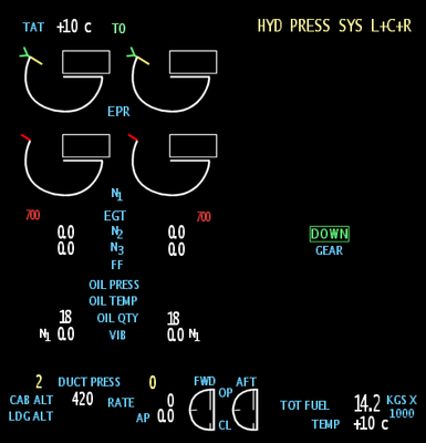

The intent of these indicators are for engine instruments and similar system displays. Here is a typical example of an engine display on a twin engine aircraft:

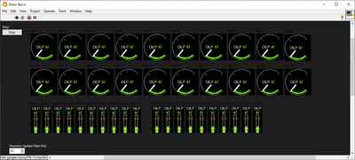

I have personally assembled screens with 40 vertical tapes, but I can't share those screens. I put together some performance tests, starting with just numeric indicators. I didn't bother building to an EXE, but I don't expect much change in CPU load in the UI thread.
Numerics only test screen:

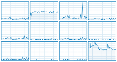

Overall CPU load is low, but that lower right logical processor is running the UI thread. The load drops to nothing when I minimize my front panel. We'll focus on that from here on:
UI thread with 40 Indicators updating at 20 Hz: about 40% which is not something I like to see:
UI Thread load when running at 10Hz: 20% which is still higher than desired, but ok:
UI Thread when running at 5Hz: 10% which is probably fine for most users:
Here comes the problem...

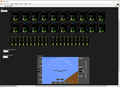

UI thread with 40 numeric indicators updating at 5Hz and one PFD updating at 10Hz:
That is certainly not ok. Also, I would hate to have an artificial horizon running at less than 10Hz. Minimizing the front panel brings the load on that UI thread down to ~60%, but that is still way too inefficient. Of note is that the second core is still burning along at 50%. My guess is that is where the background math processing is going on working with all the arrays of data that makes up this image:

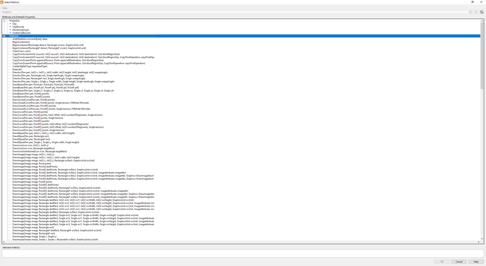

  2. Switch to .net picture control. Requires a complete re-write of the drawing methods. Advantages: hardware acceleration, adds anti-aliasing (huge for image quality), adds transparency (nice, but not necessary). Disadvantage: reliance on external .net and therefore a Windows dependency.

The .net picture control methods are ...extensive:
