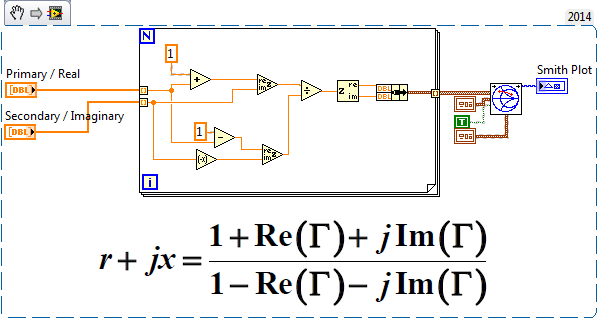

I don't know what is your expected result but you can try this (but there must be a better way).
Ben64
(4,599 Views)
This works perfectly for the format Smith Chart Complex (real & Imaginary)
Thank you very much
Michael
