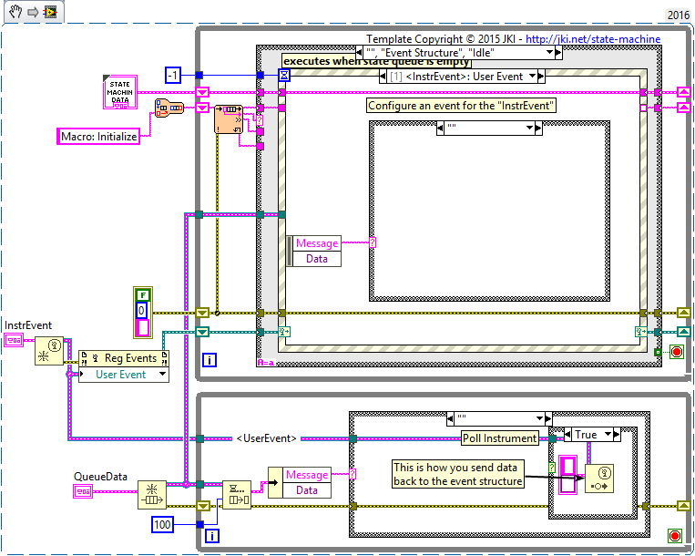

This is an example of how you might add a helper loop to the JKI SM to do the instrument communication and polling. Now, you will have to decide what data type you need, I just used a string/variant cluster. You could create a different user event for different types of messages, or have the message be part of the data and then perform different actions based on that message. This is just to show you some of the elements, it will not run, I didn't wire all the errors, I didn't destroy the user event, but it could show you the big picture 🙂 Also, I used ctrl+alt+drag to make it smaller, so if you actually drag the code into LabVIEW a lot of the JKI SM stuff will be hidden behind structures.

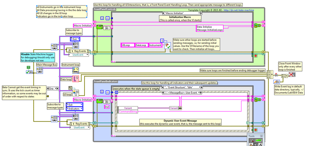

I use a JKI State machine like gregoryj. However, I set up my system a bit different.
  1. Every loop in my Main vi is a JKI State Machine.
  2. I communicate  to each loop over a Message Bus. See https://forums.ni.com/t5/Example-Program-Drafts/Message-Bus-Architecture-An-Intro/ta-p/3512280  (I have modified multiple parts of this example, but the idea is the same)
  3. Each Message has a type, command and data payload.
    1. Type means which loop, like Instrument loop, Data loop, etc
    2. Command is a string command to the state machine
    3. Data payload is a variant
  4. For each loop there is a helper loop that filters out the messages by type and only sends the ones that are subscribed to by the loop.
Here are the advantages in my opinion of this architecture:
  1. One wire can send a message anywhere in the program, that is, do need multiple queues, etc.
  2. Event loops have the most flexibility. In my loop I can mix events from DAQmx events or messages from other loops.
  3. I can make other windows pop-up, interact with front panel, send messages back etc.
Just my 2 cents.
mcduff
Example architectureExample architecture
