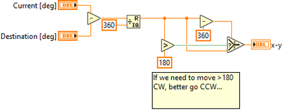

Doesn't this do that?
Note Current and Destination switched from the previous example that look like this.
When 750 and 350 are entered, -40 is the result...
It doesn't do exactly what you want here.
Why not? What do you expect to get and what do you actually get?

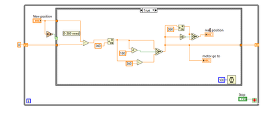

I'm not sure what you're doing here, but you again seem to mix up what I called position and angle. I would suggest that you make it very clear when you are using each of them and make sure you don't mix them. Once you calculated the number of degrees to move, you need to add that to the current position to get the new position.
I tried what wiebe@CARYA suggested. But the problem is that if I give commands to start at 0 degrees and rotate in CCW direction it calculates positions incorrectly.
For example, let's say I type 350 degrees into the "Target" control.
-Because the engine has to go 350 degrees from the nearest road
-The algorithm should return the number of degrees -10.
-and I need to send this returned value to the engine.
-The engine will come to the 350 position. This is exactly what is wanted.

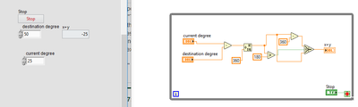

But as seen in the photo below,
first problem:
if ''Current degree'' is 25, when ''Destination Degree'' is written as 50, ''x+Y'' should be 50 NOT -25.
second problem:
I mean for the example in the picture above. Here - shouldn't be a negative number because rotations in the CW direction require + degrees, for CCW turns - degrees.
Third problem: I'm talking about the algorithm in the picture above.
What if the motor is moved to the CCW in small steps of no more than 180 degrees and the motor has to turn to the CCW because the next location is the nearest road?
- Let me give  an example. -10..-60..-120..-180...-250...-350..-359... -365...-420..
It should continue to turn in this way as long as the commands given do not require a reverse turn and as long as the commands are given in the CCW turn direction.
This algorithm is not available in the example above and is currently the most challenging problem.
