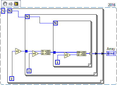

Um, as I read the original Poster's Problem Statement, it occurs to me that many of the responders are being misled by the (incorrect, I believe) use of the word "permutation" in the title.  In the example given, namely choosing three elements with repetition from [1, 2, 3, 4, 5], Altenbach is correct that this is equivalent to writing all three-digit numbers in base 5, a total of 5^3 values.  The following direct code seems to run "instanteously" (there's no obvious pause while it runs) -- it might already be posted, in which case I apologize to the earlier poster for missing their post ...
There is no such thing as instantaneously. With debugging disabled, it WILL run almost instantaneously, because of constant folding.
The main problem with your code is "scalability". You would need to almost rewrite the program from scratch for different numbers of digits (or write some complicated scripting code that would do it for you :D).
My code could of course be simplified to generate the numbers directly, but I intentionally made it even more scalable, because it is now trivial to adapt it to any other kind of input array (e.g. strings [one, two, three, four...], [cat, dog, cow, ...]; colorboxes, unevenly spaced numbers [1, 2, 3, 5, 8], enums , etc.)
Also note that my array reversal is just cosmetic to keep the element order as in the original example. I don't think speed is really an issue, you'll run out of memory well before you run out of time. 😄 (Well you generate I32, while I did it with 4x less memory :D)
But yes, here are two variations of your idea. The second is basically what the OP did, except in a better representations. There is no need for DBL to distiguish 5 values.
(I am not sure if it is better to build the three element array incrementally (like in your example) or once (as below). Doing the +1 as in your example is probably more efficient)
