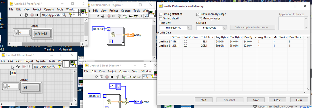

Here's a case where a buffer copy is made. (Maybe always is a strong word, except for always trusting @rolfk. I am always amazed by his responses, even though most are over my head.)
For Untitled 2 1M array doubles 8M, indicator 8M, and there is one more buffer whose name I cannot remember. Total 24MBy.
For Untitled 3 1M array doubles 8M, indicator of U8 8M, there is one more buffer whose name I cannot remember, and 1 more additional 8M buffer, a data copy.
mcduff
Make sure debugging is disabled, else there needs to be a way to probe the arrays before and after the typecast. It is impossible to predict what the compiler actually does with all that. You probably want to typecast to U64 inside the loop anyway.
Message 17 of 18
(1,036 Views)
With debugging disabled, same result.
This is just an example that shows a buffer copy with type cast; it's not meant to be a real application. You are correct that typecasting inside the loop would reduce a buffer copy. That is because on each iteration only a scalar is converted and that memory space is being reused.
