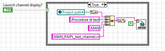

Hi, I've been tasked to create the executable for a LabView application.
I created the project, the application exe etc.. everything fine until I stepped into this:
I'm not an expert in LabView but is this something equivalent to call the SubVI forcing the setup ?

We do not see what is going on in the shown SubVI, but I think it is a dynamic call of 'MAN_PAIPL_test_channel.vi'.
For the executable you will need to provide the VI at the specified path. The VI will need 'Separate Complied Code' unchecked.
Edit: A dynamic call is similar to a SubVI call, but is asynchronous.
