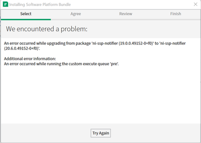

An error occurred while upgrading from package 'ni-ssp-notifier (19.0.0.49152-0+f0)' to 'ni-ssp-notifier (20.6.0.49152-0+f0)'.
I've been receiving this error while trying to install the "Academic Volume" version of Labview 2021.
There are other similar and related posts for this issue. Following the proposed troubleshooting steps,
I have checked that full-access is given to the "temp" folder in "%appdata%".
I have completely uninstalled, then reinstalled LabView and NI programs.
I have tried to install with the offline package.
One user said that the problem could only be fixed with a clean install of Win10. I'd prefer to avoid that if possible...
I've discovered that a similar error is thrown up if I attempt to remove "NI license manager" through the "NI package manager" app. There seems to be some issue with 'ni-ssp-notifier'. As a bypass, is it possible that this particular package can be manually updated to the correct version?
I've had Labview on this computer before. And, it has installed fine without issues. I ended up removing NI programs later when I discovered that it seemed to interfere and turn off my wireless adapter occasionally. My adapter is an Intel(R) Dual Band Wireless-AC 8265. And, the issue would appear after the computer was awakened from sleep-mode. The adapter would be turned off with no way to turn it back on again without restarting. After the removal of NI programs, this issue went away entirely.
So, I'm wondering if there's some interference due to this not being my first installation of LabView and NI programs on this computer... I'd like to be able to have LabView on this computer because it's a laptop and portable. And, for the purposes of interfacing with laboratory-hardware, I can easily move it where needed.
Kind regards,
Allison
Screenshot of the error:
Screenshot of the version of Labview:
Error message:
Additional error information:
An error occurred while running the custom execute queue 'pre'.
