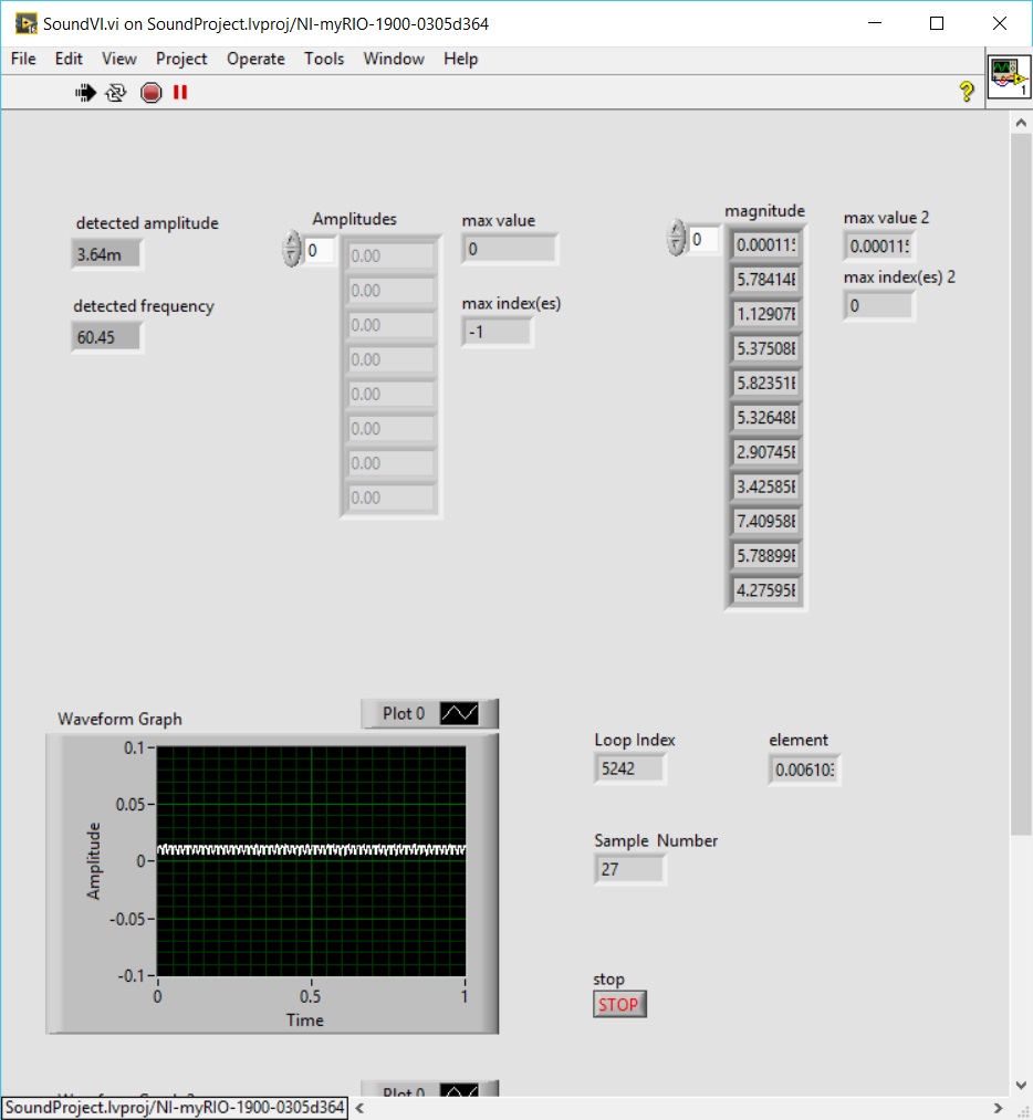

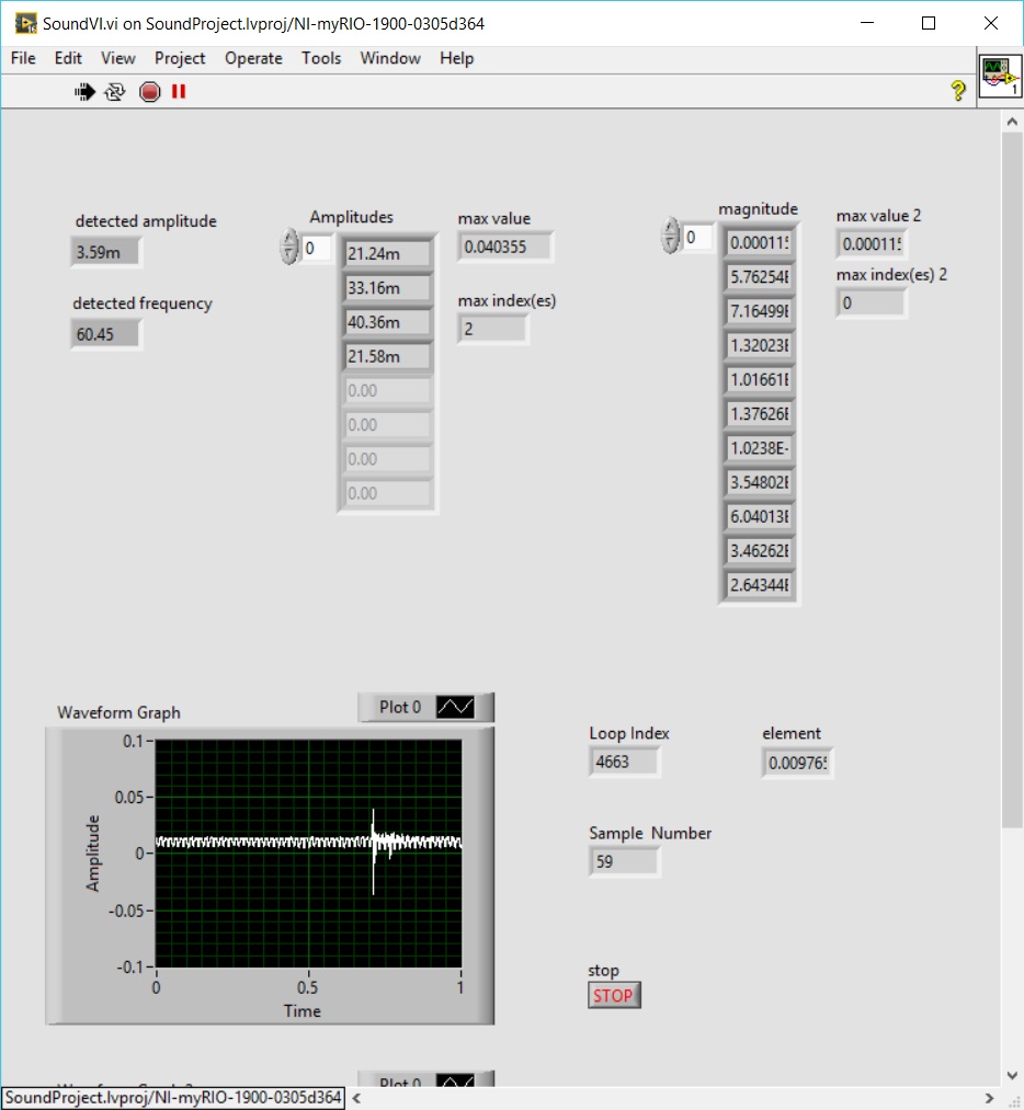

The 60 Hz you are referring to is what our mic seems to be picking up from the ambient noise, but we want to analyze the sound spikes that occur from the collisions of our bottle. We know that our VI will capture it within the 1 second snip because we have it recording under a while loop. Here is an image of the waveform graph before and after we snap our fingers (which has a similar shape to when a bottle collides):
Before (ambient noise)
After (Snap)
Notice that the "amplitudes array" activates because the amplitude exceeds a threshold of .04. So there is a definitive deviation from the ambient noise. And clearly, the waveform graph does indeed detect this. However, the outputs of the Extract Single Tone VI ("detected amplitude" and "detected frequency") seem to stay relatively the same.

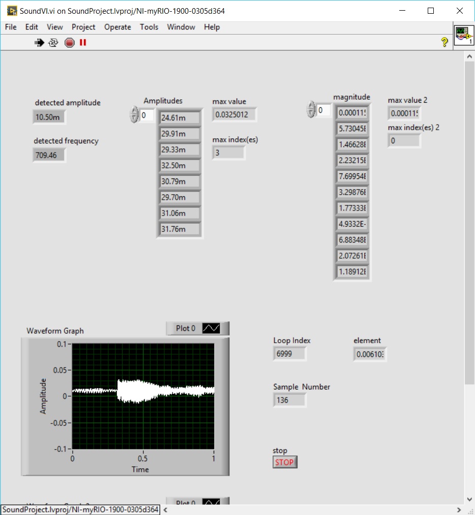

Now, here is an image when we play a recorded piano note, which has a longer sound pattern (the audio is attached):
As you can see, the frequency and amplitude have a noticeable change here. And this is fine, but seeing as the noise of a bottle hitting a surface will be more rapid, we need our VI to capture short, quick sound data as well.
Our theory as to why it won't work with short sounds is because it is a transient signal, which is not picked up by the Extract Single Tone's FFT. We are not sure how we would be able to solve this problem.
