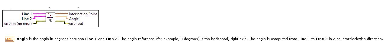

Yes i need actually the angle between the lines... The reason why i was getting "-ve" angles was because of the IMAQ intersection VI. Here the angle reference (for example, 0 degrees) is the horizontal, right axis. The angle is computed from Line 1 to Line 2
