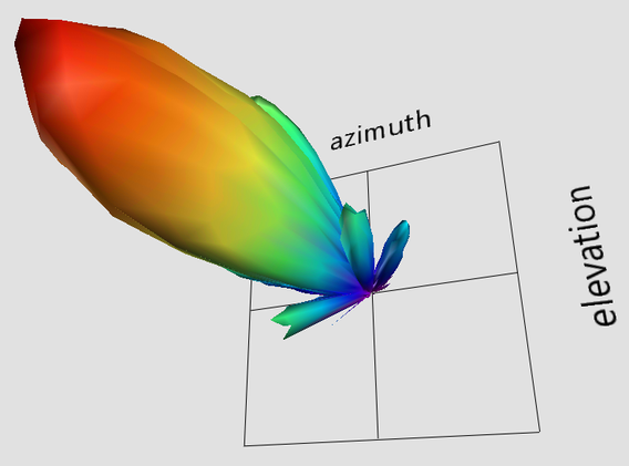

I noticed that people are a little rude on this thread and not providing answers. Since I have work on this topic recently I decided to provide some (maybe late) answers in case anyone else needs help here.
First, attached is a sample 3D data file and 3D surface plot you can use (LV2017):
To make this happen, there is a trick to do in the plot settings (right click the plot):
Then select "sperical" coordinates:
You can immediately see the plot use the data you gave it as rho, theta and phi.
The theta and phi data are degrees converted to radians.
The rho data was actual dBm powers normalized (since rho needs positive numbers, I scaled the data from +30 dB to 0 and then I just know the data is skew some factor). I'm currently researching how to scale the legend to display this information.
Hope this guides anyone stopping here to the right place in the graph.
