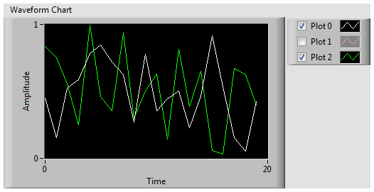

what about showing 'Plot Legend' and activating 'Plot Visibility Checkbox'?
All build in, no programming.

If you want a control for each plot, UliB is right !
Just use the native checkbox availble directly on the chart (right clikc the plot palette and activate Visibility Checkbox).
If you want to have the boolean controls somewhere else on your pane, then do as I was explaining in a previous post. And yes, you can make it efficient using an event structure to detect when  / which plot to update.
