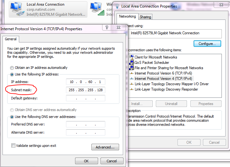

Hello count3r5tr1ke,
It is recommended to have similar IP addresses like 192.168.111.xx and 192.168.111.yy but the subnet mask is actually a different number. It also is composed of four three-digit numbers where each can be between 0-255 and it is the neighborhood where IP addresses recognize each other. If two items are in different local subnets they will not be able to communicate.
This is an example from MAX once you see your device, on the Network Settings tab, note the separate value for the subnet mask:
And then on Windows (Control Panel>Network Sharing Center>Manage Adapter Settings, right click on your selected Local Area Connection>Click on IPV4 and select Properties) you can configure the subnet to be the same:

My subnet mask on the computer is 255.255.255.0. Unfortunately, I still can't see the RIO in MAX in order to find out what I should change the computer's subnet mask to.
