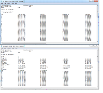

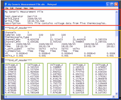

Iam writing a function that will log data in the flavor of the following image. To later on analyze it with DIAdem.File Format.PNG
Iam having trouble inserting the middle part because it overrides part of the buttom section.

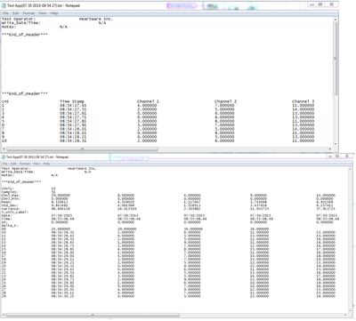

2. Leaving the space that it would take for the subheadings between "***End of Line***" delimiters.
both variants failed, it doesnt move down the last delimiter, instead it overwrites it.
