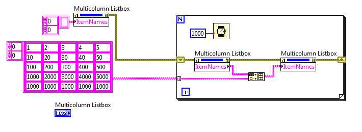

Is there any chance to append or inject the singular row to current multicolumn list box?
Now to add something at the end I have to read all data back, add it and load them again. It doesn't look efficient:

That's the only way I know to do it.  If you're adding a lot of data things might go faster if you turn on defering front panel updates until you're done adding to it.

You can use this example VI to do what you are trying to achieve or use it as a guide or base to build on it. Best wishes.

What I tend to do in these situations (assuming the you will be adding to the table a lot), is store the current item names in a shift register.  Then you just read from the shift register instead of going through the property node.  It helps memory and performance a little.

And not to forget: Use "Defer Panel Updates". This will speed up the overall performance loop and the UI.
