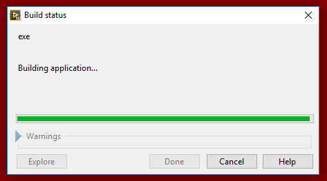

Application Builder stuck on "Building Application..."
Using LV2016 I'm having trouble building an executable. It gets stuck on the "Building application..." step. If I press Cancel, it will say it is canceling but never actually closes, and I have to end the process from Task Manager. It uses some NI-Scope functions but nothing out of the ordinary, and I am able to build a very similar application (different .lvproj) in about a minute. I've tried clearing the object cache, and disconnecting typedefs in the executable, is there anything else to try?

I am also experiencing a similar issue working in LV2016.  I wouldn't say that it is due to file sizes.  I can build the exe to a local folder and the built app is <5Mb in size.  If I try to build to a network location, the build never completes and the build status is stuck at "Building application..."

Another data point is that after staring at "Building Application..." for several minutes, I can click Cancel to cancel the build and the status will say "Canceling..." but that never completes either.  I can close the Build status dialog box while it still says "Canceling..." but then LabVIEW seems locked up and unresponsive in the project window.  I end up having to kill LabVIEW with task manager.
